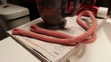

I did my first double braid splice today. 3/4" Husky Bull Rope
It was a lot easier than I ever expected. Thanks to all the people that gave me encouragement :)
Thanks Ralph!
I gotta get away from the sharpie and start using thread or something. This one isnt for me, a friend bought the hardware and cord and set the specs, I jut did it up.
