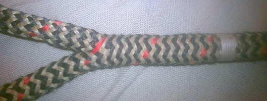

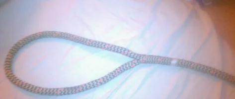

Looks good to me!
It does look like there was a mark about an inch in on the right side of the eye. Did you change the size of the eye during the project?

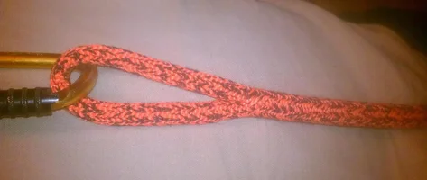

I remember my first Tachyon splice...well over an hour and tore my hands to shreds and I hadn't even fully buried the visible core of the eye. I left it for another day. I totally have them down now, and blister free! After all the Tachyon splices I've done, it makes splicing Imori feel like an absolute dream!
I could do it blindfolded...I could do it with one hand tied behind my back even...
I measured for 1/2 lines...oops. bury was 11"that was as far as I could get cover to go. I put on harness, clipped in a crab to the eye and one to butterfly knot and tow hook on my truck. Commenced to smooth and load the eye with body weight. It took some doin' but she slid together nice...next one will get a little lube an prolly go a bit easier, hopefully. Thanks to all that have contributed to the splice rack! I couldn't have done it without you, buzz brothers!
