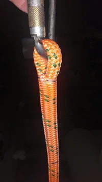

From last night. Vortex on a ct rigging plate.
My first Vortex splice, and the first time I have had trouble pushing a fid through the cover where the original core still in place. Ended up getting out my Brian Toss wand and pulling it.
pics before lock stitching

Other angle. I decide to use a non standard orientation of the plate as I think it will work out a little better for me than the more common way I've seen. Looks weird but I think I like it.

It's the dmm/tuefleberger 16 strand (safety blue) I do have the tachyon as well but this particular pic is 16 strand.
That's the Teufelberger tachyon scheme they sell overseas.

I'm going to whip it and put it to use, may put it to a pull test with my truck and a tree just to see how it acts, but I followed instructions to the T and it all went just like the instructions said so I know it is strong and done right..
