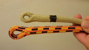

Anyone know why my i2i splices have a S shape while my 24 strand splices look good
