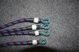

The HH is why I bought a bunch of Ultra Tech in the first place. I like it because I can pull the core back a bit and squish down the hollow cover to form a tapered tip. I do a short whip on the hollow cover and then paint the whipping with rope dope. That makes a nice tapered tip that will not unravel and is easy to thread through the dog bone. My guess is that you probably do something similar? But then I had so much Ultra Tech laying around that I decided I would use it up by making eye to eye prusik cords. That is what happens when you are semi-retired and have too much time on your hands.
Do you use a class 2 db splice for that stuff. If so where do you get the instructions? Thanks
Hadn't been doing the hollow core/whip/dope, but I will now. Been using the smaller cord, which is still pretty dogbone freindly reguardless.

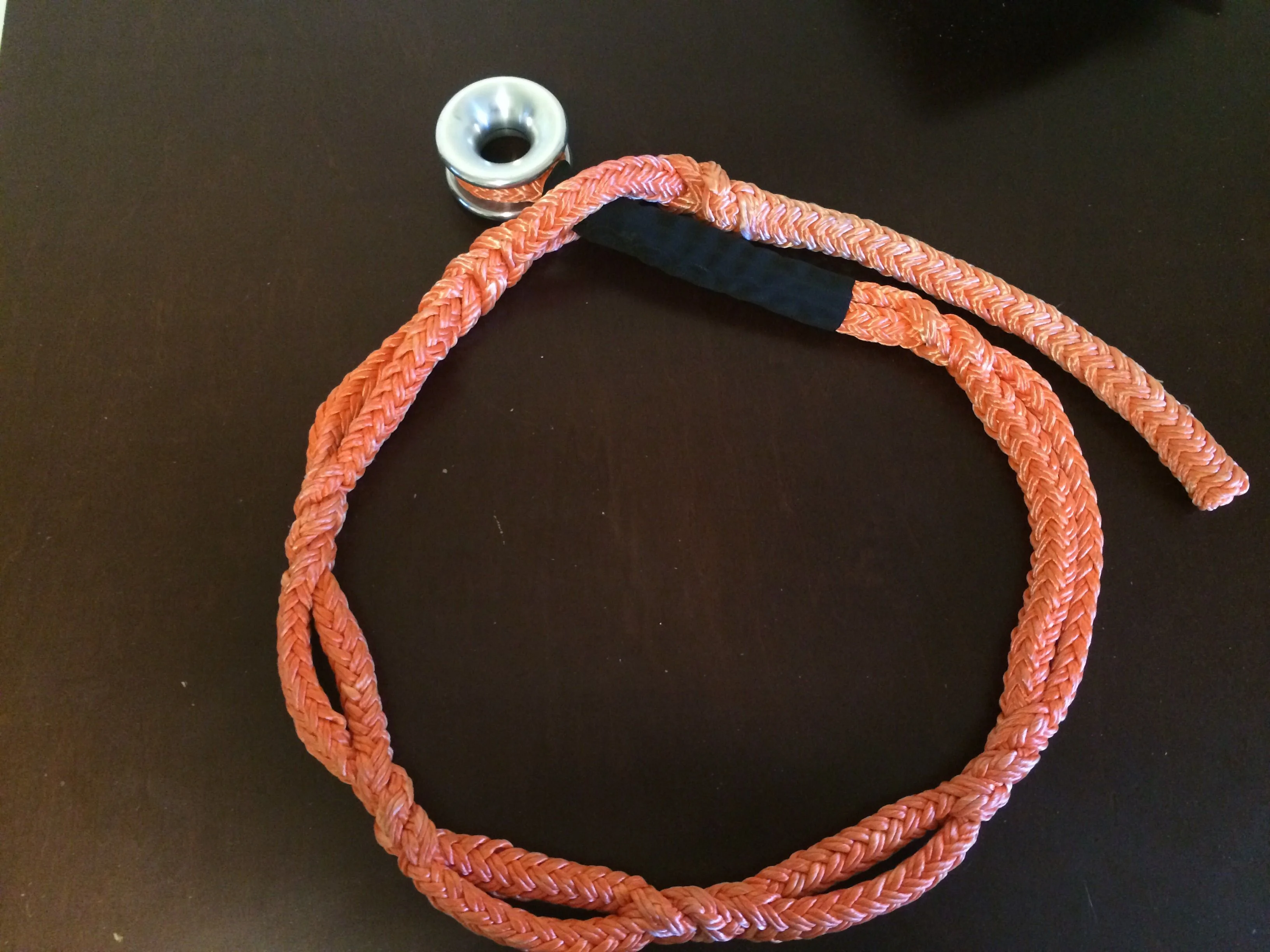

Here's an ultra ring I whipped up yesterday. It came out a bit shorter then I hoped.
