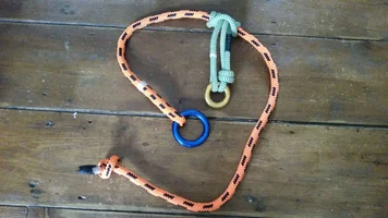

Adjustable false crotch I did a while back, haven't had the chance to climb on it yet. Using a single locked brummel around the ring and tying a Blake's hitch was my solution to not being able to get two locked brummel eyes on the ring. I've never seen it done this way before, is there a reason this shouldn't work? I'd like to do the same on a Pinto Pulley on my pulley saver in hopes it would make retrieval more reliable.
What a trip,i was thinking this exact method two days ago [emoji106]
