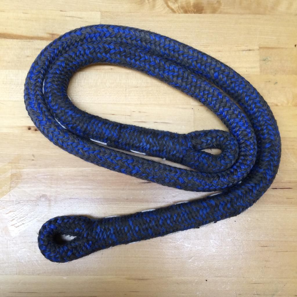

I bought the longest pulleysaver and only use like 3-5' of it because I only Ddrt for trees under 30'. So I decided to shorten it, any other splicers out their shorten theirs? Plus I like this better than that big hunk of shrink wrap that it comes with.

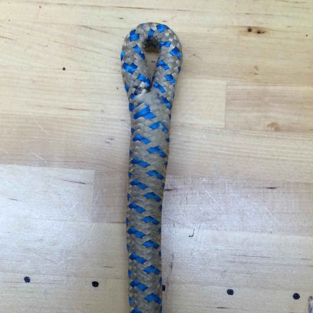

If the core is Vectran, which I believe it is, it is self abrading which means this splice is a no no. AP blue 10mm core is Dyneema and it is acceptable to splice an eye to eye with class I instructions.
image.webp Turned it into a 2.0. Three Brummell, lock stitch, whipping, then pulled the Marlow shrink tube back down over it all. Will whip and lock the Brummels with throwline tonight. Worked great today
