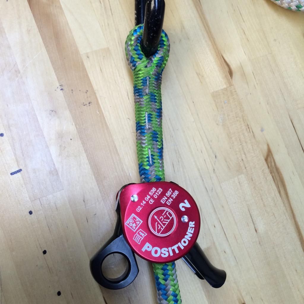

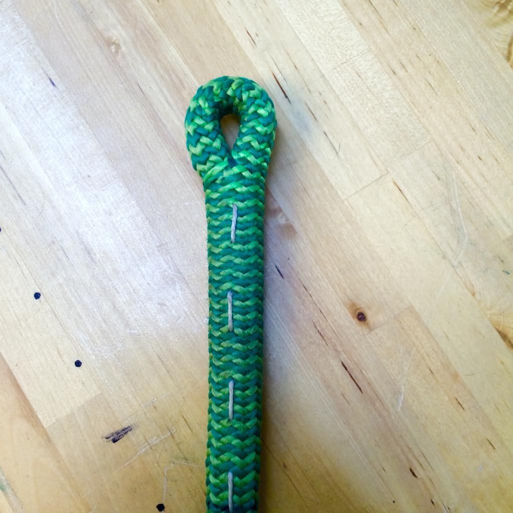

16 strand, tachyon, and kernmaster. New at splicing. Start with the toughest first and the rest are easy Haha. Still need whipping on a couple but they came out well.

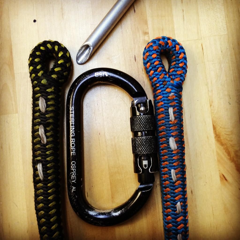

6 tachyon splices later. Finally pleased!
That stitching looks a little crooked Tyler, do it over and get it right this time. Lol. Nice looking ends. Good job.
Haha I knew someone was gonna say that, its hard using a vice and get the stitches straight. Shouldn't be too hard to pull them out and start over
Tyler can't you use some cutoffs from the tail to stitch those splices, those threads are really distracting. No just screwing with you Tyler, nice lokking splice, seriously.
Splicing up a storm Tyler! On some tough ropes too. Is there any special reason you whip-lock some splices and do a basic lock-stitch on others?
I got the shits of stitching like how I was. Such a pain and I was never satisfied with the outcome. I saw the spiderjack video and really admired that stitching technique so I copied it.
