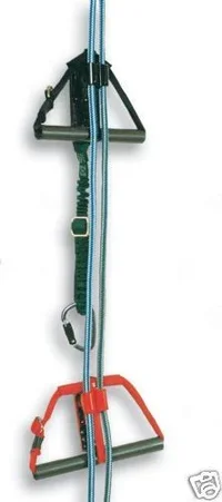

The climber was an interesting dude, in his early 60's, and using a pair of custom made double handled ascenders, one for his hands, one for his feet (which had a step/foot strap hanging off the bottom) in order to climb a pair of stationary ropes that were hanging side by side. A Stihl 201T was his weapon of choice.

The climber was using a pair of custom made double handled ascenders, one for his hands, one for his feet (which had a step/foot strap hanging off the bottom) in order to climb a pair of stationary ropes that were hanging side by side.

Was he using a Mar-Bar? You might not have seen these before Tim. Popular back in late '90s and 2000 but now out of production.
