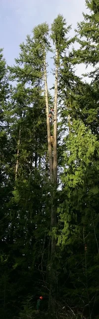

Here's pics from yesterday's monster fir....110 footer, about 54" on the butt, 20 yards of chips= abt 11000 lb, 2000 lb of limb wood, possibly 30-45,000 of trunk weight. Limbs up to 10 inches. 5-10 degree lean, cracked asphalt from root plate heaving. A few days ago, I'd set a 1/2 inch spectra line in it and guyed it to a large cedar behind the lean. Took it out to do the work as it would have gotten in the way and been a major hassle--as it was on the first tree that Matt climbed for me.
ole butterfingers had dropped his micropulley.
I got pulled up with lifeline set in pulley on end of lowering line. easiest way of all to access the canopy!
I'm at about 50 feet in this pic. From there up, I have to drop the wood onto a slight slope, so will have to employ a vertical speedline to ensure the pieces stay put and don't take out the neighbor's yard and structures. gonna be a real pain to rig...will need a tag line to tip the sections over, they're huge. From there down, I have room to drop a 47 foot butt log across the driveway. Extremely tight fit to get the log truck in the alley with two 90 degree turns, then snake out the log while he's facing the wrong way. but it'll save firewooding what I guess will be 2000-3000 board feet.
