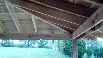

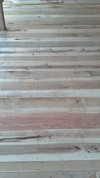

It's great to see some of this wood going to good use. Great work guys! We are doing a renovation at our house and were able to use lumber from trees we removed to build a porch. The roof and handrails were made of Poplar and the decking was a mixture of hardwoods: Red and White Oak, Hickory and Locust.
