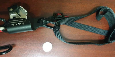

The SAKA mini is now available on my website.
Compact Self Advancing Knee Ascender for climbing a rope. In conjunction with a foot ascender (coming soon from CI), the SAKA mini allows a climber to simply walk up a rope. Easy to use, easy to store and carry.
  • 2' of super stretch bungee, solid rubber core and Dyneema cover for strength and wear resistance. 2-5 pound pull. (3 pounds at 18 inches of pull.)
  • 2' of 5/8" webbing adjustable for any reasonable stride or size of climber.
  • Simple to adjust.
  • 7.95 ounces.
  • Load bearing buckle designed and built just for the SAKA mini.
  • Compact for easy storage when not in use.
  • Uses the original SAKA ascender with progressive tooth pattern and rope friendly spring.
  • Comes with two small, 4kN rated carabiners and one 22 kN carabiner.
  • Works for climbers of all sizes, no need to choose between length or foot attachment.
  • SAKA mini video

Although it will sound like I'm trying to sell doubles, the SAKAmini cost half as much as a competing product so it still saves money.
If I want to barefoot, I use the double foot loops, and a sit-stand method of ascent.
If one is trying to avoid the side force from a foot ascender by using foot loops on each foot, 2 Saka minis could be used on each leg. A small carabiner, the one that is included, can be inserted in the small hole on the SAKA ascender. Photos below.
