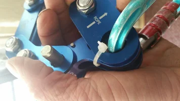

My out know it wouldn't do it for the video. Sorry for the cinematography. .
I see what you are saying Steve. Looks like you are going to want some play between the biner and swivel :nocausagracia:? It would stink to take that grommet out. Looks beautifully designed.
A rubber trap could work but would you want the nose of the carabiner pointed downwards towards the swivel for easy on/off???
I tried this biner before http://www.treestuff.com/store/catalog.asp?category_id=130&item=3530 ....but the metal trap space isn't quite large enough for the base of the runner.
Think I got my money's worth out of these. Don't mind the burrs. It's from plyers to take it off.

It is one of DMM's new offerings.
http://www.treestuff.com/store/catalog.asp?item=15776
The DMM Nexus is a compact, hot-forged swivel designed for use at junctions where torsion needs management. A high-quality internal bearing ensures smooth and reliable rotation, while the textile-friendly clip in points are perfect for carabiners or textile elements. The Nexus range has two shackles on either ends which can be removed to allow connections to fixed loops such as wire strops, rigging plates, and harness bridges.
That is a beautiful design, capable of being opened at both ends, with a swivel. It is going to sell like hotcakes.
