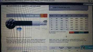

I know you know the construction.. but so others can lay there eyes on it, on paper & know the exact properties, this link is for them.
It's page 31 of catalog. Nice & clear.. poly poly dyneema
Edit - not for nothing, but for those of you who are contemplating two bridges & struggling to make the stopper terminations of regular climbing cordage fit nice & neat within your plate/paw or ring system, this 10mm solution will definitely help with that problem.. It's also comforting to know even though smaller, it's strong & durable. No guess work needed going with this smaller option.
Read this folks. This is the shit. 10mm. Breaking at 9K...huge....poly cove and non self abraiding SK75 dyneema. Now I am off to find 100 feet in 4 colors.....lol for my 3rd time.2019-08-24 23.07.07.webp
There ya go! That's the page i was trying to link.
