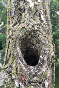

So, I bailed on the last Ash Tree in our queue. I climbed, set up the TIP, and then documented a couple of things. Here's the state of the canopy- the peeling bark was appx 20' below the TIP on the only stem that I could use, and about 60% of the canopy had to be rigged, as well as everything, including the top, once the tree was brushed out. That 'hole' was at 5" diameter section, about four feet below my feet, when standing that the TIP. It wasn't a huge tree- probably 65' to the tips, maybe 70, with 20" DBH. I've put a couple pics of my TIP 'concerns' (let alone the rest of the tree, which was also dead).
(BTW the maple (you can see in the one pic) was to far for an alternate TIP.
I referred the work to a friend with the lift - I did outline (to the client) that, with Ash Trees, if we deem them unsafe, we will come out of the tree (at no charge). I don't like being this conservative, and I hate disappointing clients (a losing money), but with the little guys, I really have to be this way, and I've noticed my headspace has changed considerably in the last 5 years, now that I have a family (re: getting old...)

That cavity isn't as concerning as the big dead limbs...but it certainly decreases strength.
That looks like big pieces to rig. If you could bomb them down, would probably have been good.
You've gotta be confident in your tie in or the whole job is a nightmare. Sounds like you did the smart thing here!

I would not feel bad. You didn’t lose money, the client just has to be willing to pay what it is worth. Good decision on your part.
