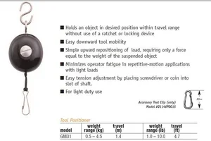

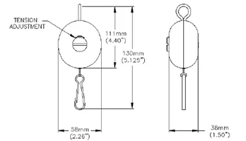

That Gear Keeper reel is nice and compact, but noticed that it only has a 22" reach. Having a plastic casing that might be fused together, the cable might not be easily replaced with string.
remember that if it says 3 lbs you have to pull 3 lbs with your body. it is much preferable to pull 2 lbs. that cotton wood climb was 65 feet to to the top of the rope. if I pull two lbs 25 times that's equivalent to picking up a 50 lbs bag of cement with my body. if it were three lbs that it would be 75 lbs.
none of the ascenders I have tried take any where near two lbs. its usually more an issue of working it past harness jumble and bridge dangle etc and clothes and mess leaves and twigs in the path that it needs to have the oomph to push through. stronger also does not mean faster.
