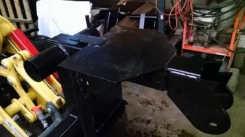

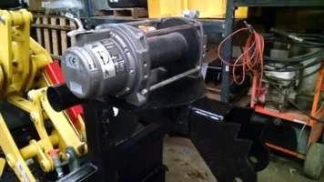

couple of Winch bracket Ideas for you - the botton pic pins on around the Bollards
yep you will have to take the scabbys off
Don' grab steel
I caught my guys grabbing the trailer hitch with the grapple, scaring the tongue and grapple
f ing up the wires - I was pissed - actually a good customer gave me the receiver Idea

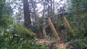

After this failed Doug-fir was "walked down" I grabbed the steeply angled trunk with a bit of finesse. Not vertical. Picked it upward to get the butt of the ground, and tracked backward.
To grapple a near-vertical log...
With grapple open, get very close to the near-vertical log,
high idle,
Quickly double-track straight back a couple inches,
Immediately track forward so as to swing your grapple forward,
grab the log.
Go to it.
Not magic.
Like many things in life, it pays to have good timing.
