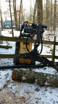

My design does not lock, you heal the long material under my log dogs, so there is a little play, its not static like the Vermeers. and because you can carry a foot or two of the log behind the tilt pin of your machine, I would wager it actually can lift more.
The biggest advantage of my grapples "hanger" and universal joint, though is feeding the chipper . the neck allows it reach out much better over the feed table. oh you can also reach over fences

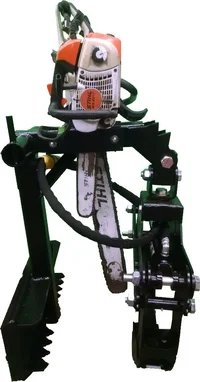

If you have ever carried your saw on your shoulder or between your legs while operating your mini - the scabbards come in awful handy at times
