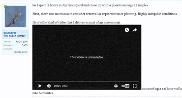

So I spent 2 hours in JayTree's yard and came up with a plan to manage 12 maples.
First, there was no reason to consider removal or replacement or planting. Highly mitigable conditions.
Here's the kind of video that I deliver as part of an assessment.
summed up a 1.6 hour walkaround into 6 minutes.
