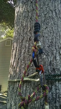

Photos of base anchors, let's see'em.
Yeah I'm a moron cause I ain't seeing the anchor configuration. Explain in colors please
I am assuming you're referring to mine?
The orange Pirate has an ATC belay device on it. The Escalator comes down, throughs the ATC, around the Pirate, back up through the ATC and then down through the anchor ring.
To lower, simply pop out the stopper knot, take the bight out of the Rock-O, pull the bight out of the ring and controlled lowering begins.
One I just threw together so some gear doesn't collect to much dust. Over all the trunk wrap is my go to or if I foresee adding line into system the blakes on an alpine.. Think country boy pa 31 put a demo vid up about it are my favorites. This one a bit gear heavy for my taste ,not too bad though. Been mostly connecting static lines escaltor or just picked up that elderid from t.s. for like 90 bucks for 130' with an eye as anchor leg of line ..then just over primary anchor point connecting via delta for multiple lines or quick link for one line. Usually a tachyon or vortex or arrowfrog for that matter or cougar orr well shit I guess it depends on my mood or the tree and day and task reaalyy .. Anywho here's a pic of the base anchor.. 14427792717401.webp
