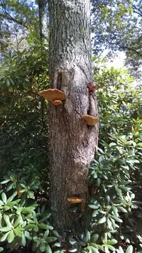

I like the wrap method best, but trees with all sorts of stuff noted above can make the trunk wrap method suck and big assed bushes ! Like this one .
