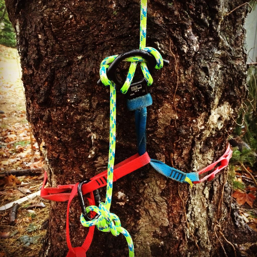

Photos of base anchors, let's see'em.

I don't use retrievable base anchors often, but when I do... This is what I use
