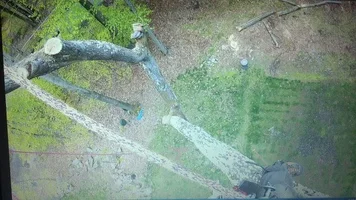

Oh you mean something like this? A 80' leaning stone dead red oak with roots cut out during installation of a septic. Tied in else where with escape plan as well just as your aying cut with one hand and used the other to take up slack in my climbing line when pieces are taking into the rigging. Other wise I would have slid around the tree gaffing out or slipped around underneath the rigging line and neither seemed like a good idea.
