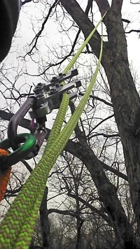

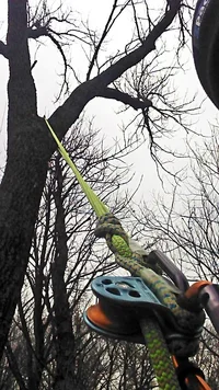

I went 85' up a white oak SRT with a Bulldog Bone on the Aztec and used Richard's magthrowbag to get a throw line across into the adjacent ash which I used to pull the tail end of the Aztec (with the hitch climber setup) across the gap. I pulled the SRT rope end across behind me and descended to the ground DdRT. (Thanks for the instructional video Richard)
Half way across...
Hitch climber DdRT on one side...
Bulldog Bone SRT on the other...
