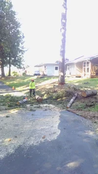

Okayyyyy, a) is it not relevant to negative rigging of blocks and b) could you give me a hint where to find the ‘old thread’ please ?

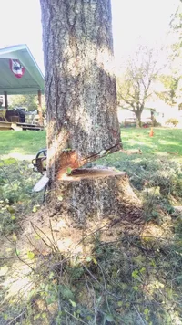

Cut deeper as stated to more undermine CoG essentially giving top more leverage to help pull own self as also reducing load that needs pulled on rear side of hinge pivot. PIVOTAL CHANGE.
Would always go over top as Tom states.
>>I think this takes the highest leverage point and then maintains thru the rotation
>>Also I think of it as a rotational input with this lacing, as are targeting rotational output as more logical to me.
Effect also shines if any flex in top as pre-setting etc.
Another high leverage potential is pulls across on rigging span between hitch on load and redirect on trunk; but only if it is SUPER tight.
My fave aerial prybar is simply a semitrailer tire changing spoon
>>tough forge and flattened spoon end fitted kerf nicely
>>enough heavy leveraged length to carry like iron workers spud wrenches on belt.
Been known to push on top of short thick as at same time leaning on lever also receiving equal opposite of top push.
Then sometimes sitting back purposefully hard to offset some of hit to line on opposite side, to more inline down trunk.
Slow turn with larger tops take longer to rotate the AND much more leverage can get you in trouble.
