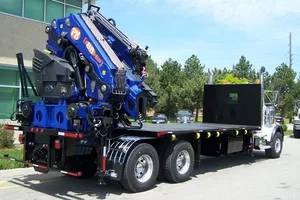

Yes thats right, if you want one like a 40 ton stickboom you may look at one like this

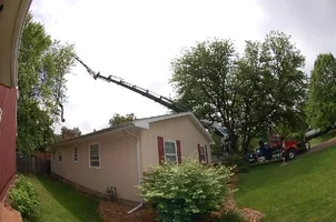

I am guessing this job here could have been easier with a kboom, not the greatest picture but there is a large red oak fallen on the house, the trunk had broken off about 20' above the roof and hanging on by a couple splinters and the top was on the on the roof. The HO hadnt taken any trees out ever, not set up to get over the canopy (regardless of the size of crane) so we worked under the trees. This was one of those days where having a internal LIM wire was very nice.
How are the kbooms with external hoses wires ect. do branches ever get inside of the boom sections like they can on regular cranes?
