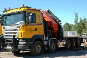

...I'd love to have one of those European Scania cab overs...
Heck yeah! I've been dreaming of a Scania with a K-boom for years...
