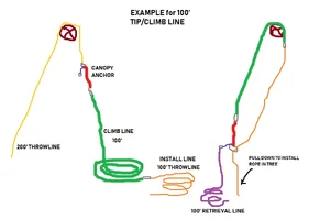

You could put 3' of 1" chafe guard on the rope below the shackle, 3 or 4 stitches at the ends to keep it in place, and you'd have a built in canopy anchor. A retrieval line clipped into the end eye is exactly the best place to make retrieval easier (having it clipped to the shackle itself is actually NOT the best... near the shackle pin actually works better). Easy install from the ground, easy retrieval. No limit on natural redirects.
It may not need a chafe guard but that's an excellent idea. I'm playing with some interesting remote release concepts beyond what can be obviously done with it, thx Jeff!

Gawd, no. On this machine (a Nextbook with 10" screen, running Winblows 10) I'm forced to use Paint to do this stuff. This thing doesn't have enough resources to run a real graphics program. I really need to get one of my desktop PCs over here. They're buried in rubble at the other house and I've been too lazy to do it.
I'm going to need one of these Moss Woods Cinching Lanyards...but 100'. What ropes are you planning on using?
I'm going with Yale Arrow Frog for my long lanyard build just because it's such a pretty line and it is a Yale 11.7mm double braid ;-) It is heavy per foot but I figure at 80' very not bad.
A 10mm 100' lanyard can happen easily for you. PMI EZ-Bend right? Back to the question asked in another thread, what's a good 10mm line for a Rope Wrench or other multicender? I think EZ Bend is the strongest candidate to-date until more info comes in on other options. Drew Bristow in the South Pacific is using one of the Beeline hitch cords for his Captain Hook line, probably 10mm. That would be nice but a bit expensive for 100'. The suppleness of Beeline is nice compared to typical 10mm kernmantles but... there may be objections due to the static loading/shock involved with an accidental drop on a high-modulus fiber core climbing line.
