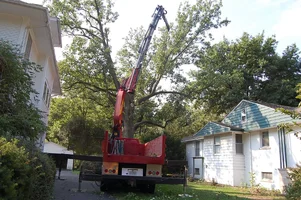

Mike and Tod (and any others) what guidelines would you give for estimating weights of the brushy picks especially?

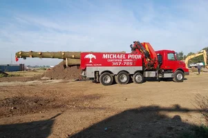

Mike. Do you put red or orange flags on the back end of the logs sticking out the rear?
The photos of that machine in action never gets old. Keep 'em commin'! Shoot, if see that thing enough, I'll want to get one.

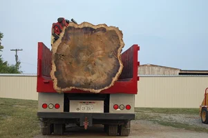

I agree. With the truck check points in my area you could never get away with loading a truck like that. They would take a truck loaded like that out of service till it was loaded properly.
Yeah Jamin, I nail red flags to the ends of the logs any time they stick out 3 feet or more to make it legal. Todd the payload is 16000 lbs so i'm pushing it there. Hey Gord, it all depends on branch &leaf density, species, etc. but on lightly foliaged stems multiply the log weight by 2 or 3. If i have a green ash with dense & sprawling branches (for example) that rule won't work! Hey Mark Chisholm, Tell me more about that K- boom you worked with in Norway! Did it have a fly-jib?,? Reach? Etc.

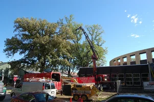

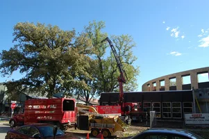

Untying the tagline! The ironworkers were upset the trees didn't come down first, they had to work around them to set the steel. They said it took several extra hours!
