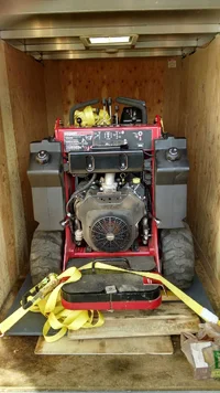

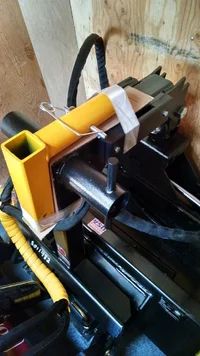

Finally took some pics, got the grapple yesterday. Added some better D-Rings to the trailer and paced in all in.
