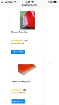

For those interested a couple bucket clamp on devices I got from a company "Ratchet Rake". Quality isn't bad for the cost @$300 each. First one was what I was pushing snow around with. Second one will be used for ripping ground vines and gravel driveways.
I looked at that myself, let know how you like it. Looked like it would make a good shear for bamboo patches, which we have lots of around here. People love them until they take over their yards.
