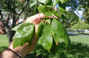

Here's one alternative I've done. Cambistat app while later soil injecting ammonium sulfate and Mn EDTA.
Excellent green-up but Im not crazy about the appearance of smaller leaves and leaf stacking. Got this job from HO who said no one had been able to correct the problem. Soil test performed to show to them what really was lacking or in excess.20160927_144919-1.webp 20160927_144942-1.webp
