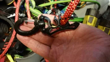

Scuba clip just arrived, looks sturdy for a plastic clip, 11mm work pro snaps in pretty tight, I don't think it would hold a much larger diameter line.
Haven't tried it in a tree yet, got 4 more inches of snow last night :raro2:

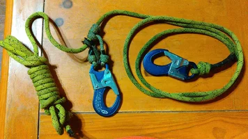

I have the lanyard manager clips i use from treestuff. I have probably 40 to 50 feet on my lanyard that i fly with everyday. I regularly dont use more than 15 feet, but i always used to think 'man i wish i just had a little more lanyard' on those tougher prunes. I daisy chain it all and seperate it into 3 sections with the manager clips. If i had my saddle with me id take a picture. Sure it weighs a ton, especially with the cougar blue im using, but im always prepared. I use it as a second climbing line on real sketchy limbwalks with srt. So far i havent once wished it was shorter
