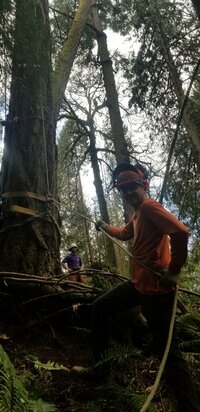

I did one a few years ago that was an absolute monster. We had 5 GRCS units to guy and rig down the tree. Tree was in yard A. Leaning towards garage/office in yard B. Brush left the property out yard C. I took two days to get it rigged and got it down to the contact point. Robert Bundy released the contact point and did the lower log in one day. Day 4 was derigging. Big conifers in a suburban setting can make for some exciting tree work.

I worked for the company Ryan was contractor for on that project. Was a new groundie at the time. Here’s some more photos/videos from the project of Ryan and Robert taking on that uprooted and pinned Doug-fir. Definitely the gnarliest rigging scenario I’ve ever been a part of. Can see our drag path across that small foot bridge in “yard C”
