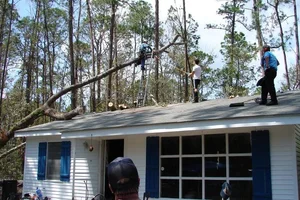

For your viewing pleasure.

I would have liked to see the swinging arc of that chunk you were roping.
Good eye...ever seen the cartoon of the groundie water skiing across the yard??? /forum/images/graemlins/crazy.gif

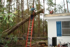

I was preparing a work safety presentation a while back and did a Googl picture search on the topic of "ladders". I came up with this. I don't know what the story behind it is, but who cares?! The pictures speak for themselves! I especially love the bits of wood nailed to the stem as supplementary rungs when the ladder turned out to be to short after all...

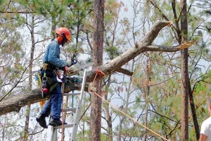

Gary,
In the picture labeled "close up" it looks like the rigging is attached to the tipped tree. Is that so?
How is the climber secured? It looks like he's just standing on the ladder. If so, it gives me chills...so unsafe.

Gary,
Yes, rigging is on the tree. Look down and left...main trunk/fork is still supported by house...root ball was still firmly rooted.
Lots of limb weight had been removed previously to this picture. Limbs were cut and piled on the house and chunks were dropped into the pile until the wood got too big.
Once that long section was rigged off, the main trunk was winched up to a strong belay and lifted off house...then chunks were cut/controlled until the trunk was short enough to drop it entirely into the mud.
Climber is lanyarded to spar. Ladder is tied (tight) to spar.

looks like the climber could of maybe tied into the pine next to the house just incase.
Sure did want to but most possible TIPS were at least 80 feet away...some of them had busted tops...this was at Katrina.

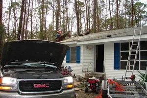

The limbs and small pieces were hinged into brush piled on roof. These bigger pieces we tied off. After this one, we took smaller ones...less roof skiing.
No GRCS available...a Warn winch was used to lift the trunk off roof when the piece on the roof was cut free...the winch was also supporting trunk in the blurry picture.
And just to save concern, in the blurry pict, the power line wasn't under the trunk...just looks that way...also, there was no power anywhere, anyway.
The tree broke some shingles but luckily did not penetrate all the way through the roof. The biggest worry was the open and overflowing septic tank right beside the house...the round five foot diameter concrete cover was half off (don't know why). The watertable had risen so much that it was flooding out...phew!!
