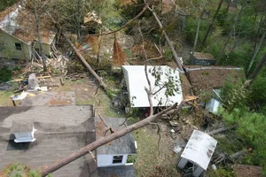

A high line is how I safetied off for the tree in the attached picture. The tree top was rigged off itself when not over the house...once over the house, we rigged off a big pine about 20-30 feet off to one side...pieces were cut and tagline/belayed over to the belay tree adn then lowered.
Re: the tree being discussed in this thread...we considered briefly a high line but the rigging would have taken a LONG time..and the trees we could have used were at least 150 feet apart..we didn't have the time or gear to rig that.

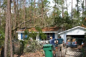

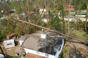

Different tree, different ladder...still Katrina, same job.
We had just finished taking the top out where it extended over the house on the left...trying to miss the fence (we did). There was a "Bubba pool" under the tree...4 ft wide, 8 ft long, one ft deep...perfect size to practice Bubba belly busters in...or to keep a gator.

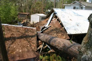

Ladder removed, starting to make cuts...snugged in tight. Maybe I could have rigged some outrigger safety lines here...I didn't, so I guess there was a good reason.
Was the tree tied off side to side to prevent slippage? We don't trust trees laying on obstacles and tie off every which way to prevent movement.
Not tied off but secured...it had sliced thru the shop/shed. We had to use tongs to skid two foot chunks up ramps and thru the gap in the wall.
I safetied off to the exposed timbers of the shed when working on the tin.

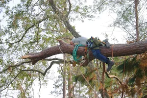

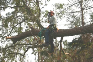

This is my lanyard anchor while working on tin roof...I had to clip into the D rings with the lanyard running up to the safety behind me...leaning downhill like doing an abseil.
Anybody else had to "abseil" doing treework before?
