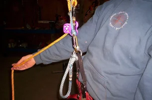

basically, Its a way to get the same effect as at AB(anchor Bridge) system with one part as opposed to two. I guess its not the best pic but I was trying to show that with the cmi(mickey mouse) pulley and one leg(of the AB system) girthed to the sliding d along with a biner, when extended, you get the same effect. Hope that clears it up a bit in response to your two attachment point query.
Steve,
That single bridge version works great with the lock jack sport as well as the mickey mouse and hitch climber pulleys. The one issue I would mention if you plan to switch to that set up is that your hitch knot will be extremely close to your anchor section of rope which may cause your fingers to get pinched as well as affect the function of the hitch. That aside many people prefer Rogers type of set up to the double leg version.

I don't care for the micro mouse pulley myself. I use one leg of the Anchor Bridge on my Butterfly in a similar configuration as whats in Roger's picture. I set it up a little different though. The Anchor Bridge just goes between the orange biner and the aluminum ring. (See attatchment)
It works great.
