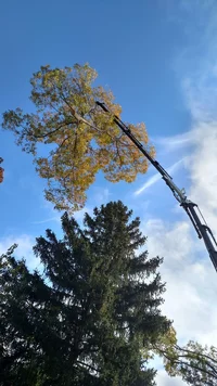

We run an Effer 655 6+6+2HD without a grapple saw. I couldnt agree more with everything treecareinc wrote above. The grapple saw would slow us down. We are a high production company and taking baby bites from a tree with a limited capacity manual extension is not my idea of increasing effeciency. If you dont have a skilled climber who can balance large picks weighing in 80%+ capacity of that kboom you just spent a boatload of money then you aren't seeing the full benefits of what that crane can do.
If you don't want to employ a skilled climber or just rather not have the risk of having a climber in a tree I see the benefit of being the old guy in a lawn chair removing trees, and yes I'm getting old so it doesn't sound like a bad idea, until then what's a few more grey hairs.
