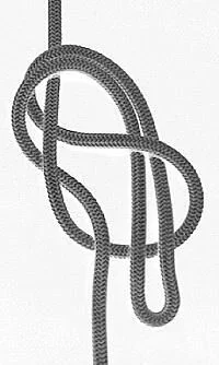

If you mean a three-loop bowline, that's a bowline-with-a-bight (to differentiate it from the two-loop bowline-on-a-bight).
I would think that arborists would know it as the saddle bowline, as it was the original rope saddle for tree climbers.Bowline With a Bight (3 loop).webp
I would think that arborists would know it as the saddle bowline, as it was the original rope saddle for tree climbers.View attachment 29822

OK, I found the farmer's loop. It appears to be a distant relative of the bowline family - perhaps a cross-breed between bowline and butterly. And it seems to be somewhat directional.
I was misled by the discussion on MasterBlaster which talked about a "3-ring-circus" due to its three loops.
If a directional midline loop is needed, the in-line-8-on-a-bight is more appropriate. The butterfly is better for a bi-directional midline loop. So I'm not seeing any particular advantage to this loop knot.

I can't find it called circus bowline really anywhere... macswan introduced it as a circus bowline in another thread, so I have called it the circus bowline because it's more fun.
I find it easier to untie than the butterfly or the 8 after a heavy load.
