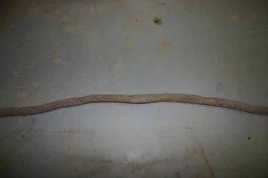

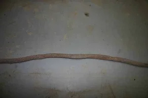

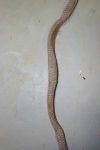

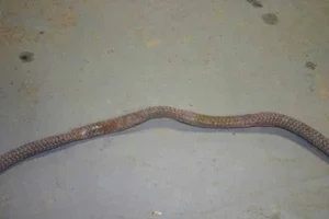

is this rope good still
allmark
Participating member
This has been girth hitched for a spider leg. What do you think.
Mark, what's the history of the rope? Was it overloaded or shockloaded, how old is it(cycles to failures)?
I would think that it is probably ok if you know its prior use. I have quite a few prussik loops that look that way , but have never been trashed. Even some of my lanyard hip prusiks look like this sometimes.
It hasn't been overloaded just left on the shackle. I worked it out some. There are no strands broke yet. No major shock loading. Probably made 100 picks with it up to 2500#
How about using a splice as you mentioned but with one of those large plastic teardrop eyes to help support the rope? I think I got mine when I was out at Kuemmerlings.
i don't like deformed rope; i'd cut that part off or degrade it. Inconsistent diameter and flat spots are 2 key identifiers to possibilities of internal damage in my book. A double braid specifically uses it's internals for loading.
Even if theoretically good; you really don't know; and it would like break the religion and respect mantra for the handling and coddling soft-wear.
What type/size rope is that Mark? Spydey implies its a double braid. That would be my guess too.
You could change to a loose weave 12 strand such as Tenex, Nerex, Yalex. Stronger than DB and the loose weave wouldn't deform so much on the hook.
Or Amsteel.
Excellent question. One can't tell by just looking at the rope. You have to know it's history; how it was used, hitched, on what size rope was it hitched to, if it was exposed to more than a 20% load. Photo's don't tell all.
It's definitely a double braid. I'm guessing it's a full polyester rope. Looks like Stable Braid with that one blue tracer.
I can't tell from the pictures, but is there any glazing in the fibers? That' can be a sign of over loading- though just because there is NO glazing, doesn't mean that it WASN'T overloaded.
If it was my rope, after doing with it what you've described, I'd retire it. You had a good run with it, you got your money's worth, now it's time to cash out while your ahead!

It is stablebraid. I took it off to retire it. I just wanted to see what all of you thought. Rope is alot cheaper than injuries or property damage. I have a place near me I can break it. If I get time Ill bring it there.
