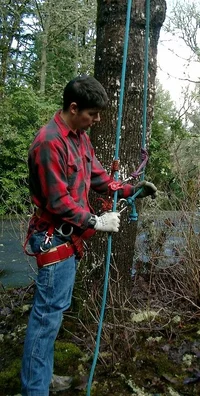

Hey Panthro, rain let up today so i was able to get some shots of my setup. The first is self advancing hitch dealy. I think my bridge was too short or something because it was very hard to advance. I hope picture is clear, pull down tail end and red pulley advances red hitch.

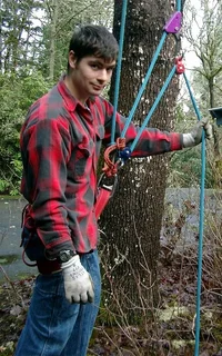

Here's the next one i tried, an adaptation of that RADS diagram, or as Mark called it, "the geriatric assist", which is a fitting name because it requires almost no effort to climb. I think this would work great for a long climb.
In case it isnt clear whats going on, everything is attached the running end, which is in my hand. When i pull down, the blue pulley on my saddle automatically advances the red hitch. after a few pulls, i have to reposition the purple ascender up higher.

sizzler I would push your knot for the pulley up a little and lenghtnen your bridge. This will give you more distance per pull. the farther out you stretch the more efficient it will be. Have you tried footlocking the tail(running end) in that set up?
Picture was great. I have not tried attaching a pulley to the climber side of the rope before...looks like it should work...maybe a different knot for your belay hitch?
That is a very neat, concise setup. What attaches the red pulley to the purple ascender? (what type ascender/rope lock is that?)
It looks efficient. Keep us posted on how it does.

"What attaches the red pulley to the purple ascender? (what type ascender/rope lock is that?)"
its hard to see, but there's a biner in between the two. and the ascender is Petzl something, but i dont know. its pretty bulky and i dont use it unless i have to.
