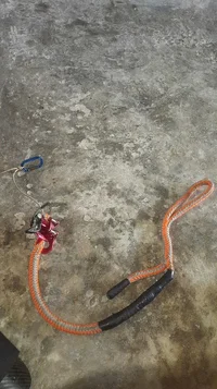

Something to pull up on the HH or RW, like a neck tether or over the shoulder lanyard, will advance the positioner on the rope when there is enough rope weight below, as you climb. A throw-weight or bundled up coils of rope ( like a closed-form of the rope throwing knot) hung below you will allow the rope to have enough weight.
I just use my trim saw tied on my tail. Most the time I’m have a little ways to go before I need it.
Certainly something to self tend the hitch is the way to go. Personally the laynard over the shoulder worked well, until there is a quick thing to cut or finding myself wanting to snap into the tree. It was a extra step I didn’t care for. Never liked the idea of something around my neck either (always have taken the pull cord out of hooded jackets too). I bough a decent chest harness on eBay and took the extra gear loops off, love it and call it my bra

@rico; I'm no veteran, but I saw a video recently by August Hunicke in which I think he said that the combination of the Petzl Zig-Zag with the Rope Wrench was the smoothest thing going for SRT. I don't think the Zig-Zag is mid-line attachable, though, and use of it in SRT might violate Petzl's recommendations for its use. August and some others have these really cool looking mechanical tethers for the Rope Wrench/Zig Zag combination.
All of this is just something for you to ponder for the future, maybe. The Hitch Hiker works all by itself.
My own setup for SRT tending is to use one of those small SRT tending harnesses, but to add another piece of webbing that runs from the back of the tending harness up & over my shoulder on a diagonal, which helps to keep it from slipping off my shoulder. It actually has two heads on it, now that I think of it. One for a spring loaded clevis for tending, and a 2nd head for a small pulley attached to the climbing rope, which helps to keep me in a vertical orientation. Probably too busy a setup for an experienced climber like yourself, but it works for me.

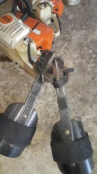

Try getting a pair of geckos with an ascender on one and a hook eye on the other. The hook eye you can incorporate a SAKA or HAAS for simply walking up the rope with gaffs. Add a chest harness or neckie for tending your system. On your conifers you can still spike up but have the system fairleaded by the rope in the ascender....no kneeascender needed but you have to set your line obviously....hope this makes sense...I only work in large spreading hardwoods and mostly use gaffs doing crane removals which are a few a year for harvesting old large mahogany trees or on a stick to be roped....or chunked.
Another alternative is a footloop kneeascender and the foot ascender under the gaff if you do not want to switch gaff set types...a cheaper but yet still effective solution...2018-04-11 12.56.09.webp

I've had a hard time justifying buying a knee-type ascender. The southeastern canopy isn't all that tall (~50-100 feet in most cases) and I usually ascend 3 times per week, staying aloft through lunch hour when necessary. When I weigh buying a knee ascenders against, say, buying another bracing drill bit, I buy the bit, you know? Then I just ascend at modest speed on my pantin. I regain some of the time by not having to attach all the bells and whistles of my ascent system - no chest harness, no knee ascender, no tending tether... That's a lot of time lost attaching and detaching all of that. You ever feel like that, @swingdude , or do you just buy everything, or... what do you think? I know you have a modest canopy height too.
I only ever use a knee ascender for initial ascent to TIP....that is it. I do this because it is a great warm up and ergonomic. I have only bought 1 knee ascender. Michael gave me 4 HAAS's and Richard gave me 2 SAKA's. But used them at comps for Ascent event and loaned to folk I get in the canopy. Once I am working a tree I will just use a footie to go up when necessary.
