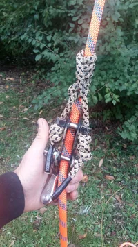

Ok.. so.. I finally got some of that fuzzy HRC to try on this HHX... & What do ya know.. all issues I've had with engagement have disappeared.. the smooth cover of the Drenaline & the fuzzy HRC is the shit!! It grabs like it should & releases like no other 8mm cordage I've experienced.. when i try to collapse the coils, it's almost as if they are greased... Hopefully this don't change much as it wears in..

This Yale 12.6mm Kernmaster / Beeline combo is slippy, it's a super new rope. So maybe it just needs a wash and some wear in time, right now it won't creep from a stop. It does gently slide to a stop when releasing the hitch while bombing. Kinda neat "soft" stop, kinda unsettling feeling like the hitch isn't instantly grabbing.

Try reversing the direction you are wrapping that knut h. As in the video from climbing innovations, Richard pointed out, and I have found it to be true, that if the tails of the hitch cord are parallel to the dog bone slot, the hitch will grab and tend better. So if the spine is facing you, with the knut h wrap around the back, then under, and back the other way across the front, followed by your wraps with the top side tail coming down the spine side. Let me know if it works better, I'm curious if you get the same result I did.

Now.. I've been coming at it from a different angle.. no pun intended.. I've always felt that wrapping to the spine side made it noticablely harder to tend depending on circumstance... i know Rich has some suggestions specifically for certain hitches, however, it wasn't until Rico mentioned how much easier tending was when wrapping to to bone side that i actually tried it & noticed a huge difference in tending performance.. That's not to say, that in my personal experience, there wasn't a compromise in other aspects though..
I do want to note something i thought was odd in one of his "hitch cord testing" videos that I'm wondering if anyone else picked up on.. In that video where that large selection of hitch cords were being run through & then deliberated on about performance aspects.. He would show how easy it was too tend each selection after landing on the ground.. The issue i saw within that was, on every landing he continued downward with only hand pressure on the device.. In others words, only showcasing the cordage/hitch tending ability after being broken free of any binding weight that would be on it in most situations aloft.. When I'm in the tree, I'm not paying out unweighted slack before trying to tend things.. 99% of the time, that hitch is loaded with my hefty ass. I think that's why all those combos worked so easily on camera. This isn't an attack on him by any means, I could never hold a candle to the content/effort he provides.. It was probably just a matter of expedience/time/filming.. Its just something I've been wondering if anyone else picked up on..
About Richard’s testing method, as long as all the hitches are tensioned the same by hand, it is a valid process. If only testing one hitch you would want full body weight, as you’re stating.
I have tried both configurations and notice a slight difference. The hitch engagement seems to be more related to the length of the legs and the "finish" or how the lengths differ. If the lower leg of the hitch or the upper leg (to the wraps) engages first. Also how much memory the cordage has. As shown it instantly was engaging, just with not a lot of force. I mostly attribute this to the "waxy" feel of the new rope, also the tighter / slippery jacket. But I will try tieing it opposite next time (& adding a turn), for science! Also, it is kinda unnerving to me to have that much motion that I'm not expecting.

I find i allows me to load the hitch a bit harder without having it bind up & become a dedicated effort to break free after.. obviously there's a soft stop & then there's not enough wraps & slipping... But it sounds as if you close to that happy medium.
If its a little too slippery try shortening up the hitch a little, or have the prussic legs load from the other side (spin the hitch 180 degrees in relation to the HH).
