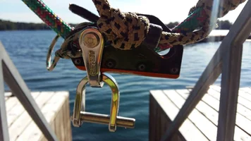

I finally picked up a couple of Quickies, the cheaper cast ones. They are okay seemingly on the original HH. They did bind up a bit when they unweighted the reweighted behind the body of the HH. 8mm Beeline, Knut 4 wraps, dreamy.
View attachment 62439View attachment 62438
Just out of curiosity Tom..
Did you try it without the second quickie in there? Is there a possibility that the tending loop is causing the link to bind against the spine if the HH?
In all honesty Tom, i don't think these tools are made for underwater scuba use.. you attempting to deep six them there?;)
