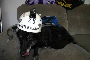

attached a pic of the camera on a helmet...it doesnt look too bad....and on another note, i REALLY like the look of that helmet, can anyone ID it?
Steve, this is not the same helmet but very similar. its Vaude. A stockist near me has one in red which is a dark, burgundy red. Its very very light, too small for my fat head but might suit you nicely. They do mail order if your interested.
