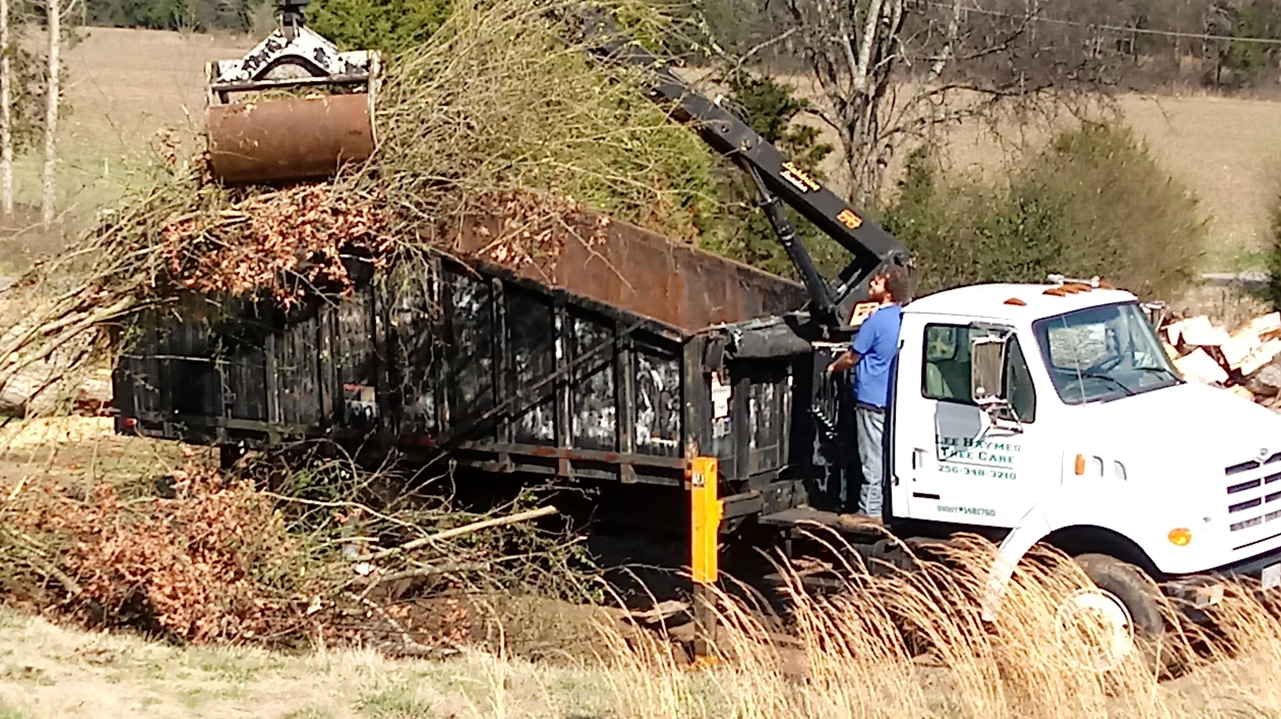

Please share pictures of your grapple truck when you have time.
I had a debris grapple on my truck and would haul tree debris, logs, stump chips, dirt, whatever I needed in it, no problem.
Its a 2001 sterling with a 5.9 cummins and a 6 speed Allison auto. At some point the bed will definitely be getting some paint. Its new enough to us that were still really learning how to use it.
