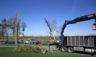

My production is not through the roof but I'm eyeing used tandem cab and chassis to put either a kboom or a grapple on. The way I figure, if I can plum a grapple on a kboom I can load logs as well as use it as a crane. How much slower is a kboom? I was figuring about half speed but it seems like they can lift more.
I'd like to have around a 20k payload capacity but as powerful kboom as possible for lifting. It's just very difficult for me to talk to guys about kbooms in my area because no one used them for tree work. It's strictly stick booms and prentice grapples.
There are plenty of people that use K Booms for tree work, but very very few that use K booms as loaders. I'm fixing to roll out, but the K boom is substantially slower than a loader. I would think your average cycle times would be substantially slower than 2:1. Also all of your exposed hydraulics, the extension cylinders, their hard lines, etc out to the tip of the boom don't make for something that's good at inadvertent contact.
The A frame Palfinger loaders have boom options out to 32'. The out and down style outriggers can get out to 42', but that longest model would be a bit unwieldy for using in the city.
Again, there's no way I would use a crane as a loader myself.

One of the other problems of using a kboom as a loader is you wouldn't want to stuff and pack debris into the boxes the way you can with a loader. Lumberjack has it good because he can dispose of mixed loads, I have to have clean wood or chip loads, stumps and brush are really expense. But anyway to maximize space in the box you're going to have to push and pull, press and wiggle and none of that is going to good on a boom with alot of sections and elbows
I would just be loading logs into the back and maybe occasionally chip into it.
If I plumed a grapple like this, would I be able to rig picks to it like a crane with the grapple still on? I wouldn't grab pieces with the grapple and cut since shit could go wrong.
You'd be limited to the swl of the rotator then not the boom. Better to just remove the grapple, pic the tree down and put the grapple on to load. Worst case you have a pin and 4 quick connect hyd fittings

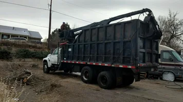

So after searching EVERYDAY, up to 15 times PER DAY, for the last couple years to the point where I was having dreams about it on a nightly basis, I'm finally the proud owner of a grapple truck. 1995, F800 with tag axle, 8.3 cummins, 22 foot dump, 10 speed, Hood 7000 loader, etc. She's not a beauty queen but def not an eye sore either. And she didn't break the bank! Anyways, for anyone that MIGHT care, just had to post it.IMG_20170114_090732956_HDR1.webp IMG_17591.webp
Ha, good for you! That looks like it would really get the work done.
