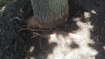

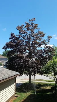

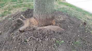

Since my problem is similar, I'll start here.
This tree is approximately 15 years old. I have lived here for 10 years. Noticed thinning crown this year. After a little dirt removal I have found the roots are girdled. Should I have it "air spaded" and repaired or is it too old... too far gone?
