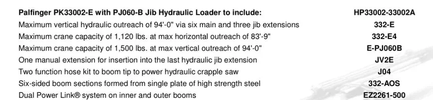

Here's a couple of pictures from Palfinger load charts
That is a PJ 060B jib on a PK33002. The next one is a PJ 080Ç on a PK40002.
There's a note in the brochure right below this chart that says "the outreaches stated are with a boom angle of 20 degrees and are therefore not the maximum".

Is the jib configuation the PJ060B JV2 DPS PLUS ? Can you attach or show a link for the load chart? Using just the model number (pk33002) I couldn't find anything that came close to the specs that you listed. But, one brochure included a single chart with a fly jib and the number above, and the specs seemed close to yours.
The Tree-Mek is being spec'd with a PK33002-E crane and PJ060-B Jib. Max vertical reach is 94'-0" (without the manual extension/s) with 1500 pound capacity. Max horizontal reach is 83'-9" (without manual extension/s) with 1120 pounds capacity. At least that is what is on my order from Tiffin Crane.
The sawhead is about 700 pounds, so deduct that for max capacity with grapple saw. And deduct the weight of any manual or portion of (I understand someone cut their's shorter to reduce weight) manual extensions used to get the head and branches away from the hose trays

Marc,
I'm sorry I misrepresented the length. I remembered those numbers from my conversations but when I pulled my bid it was as Ben described. Here is my factual stats.
