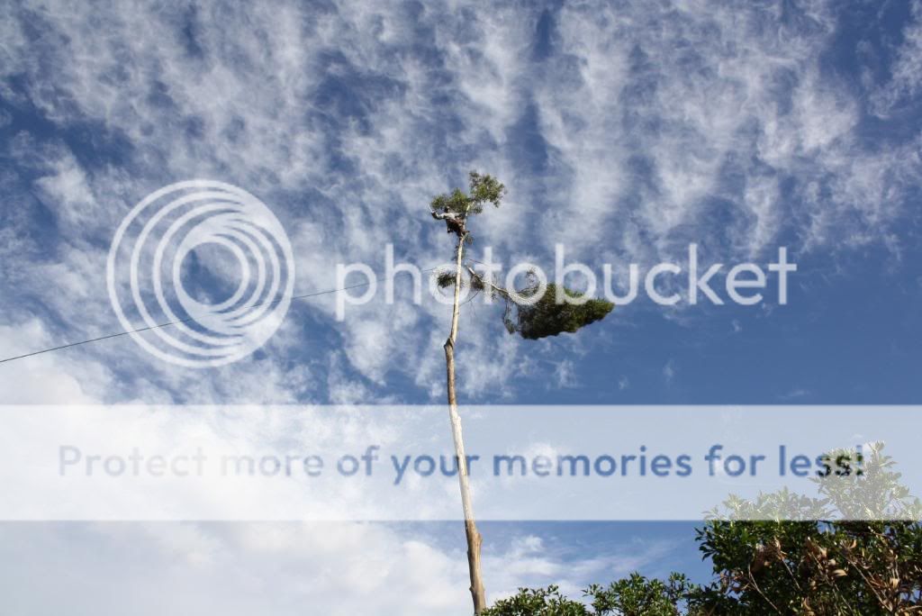

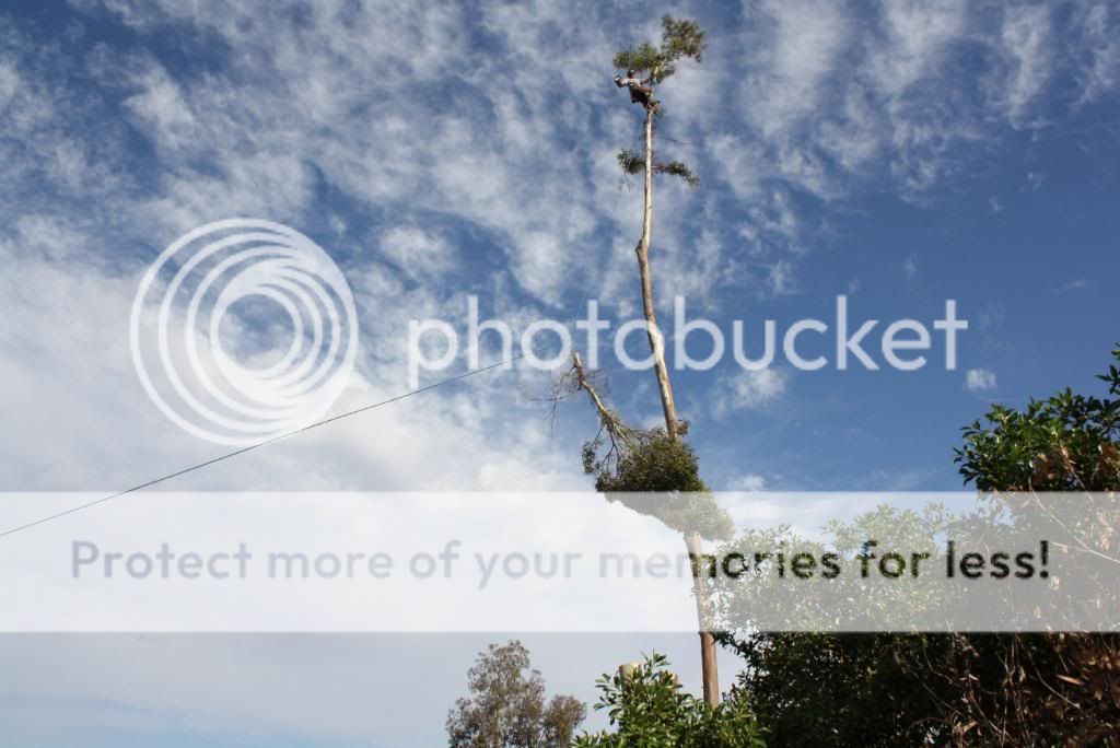

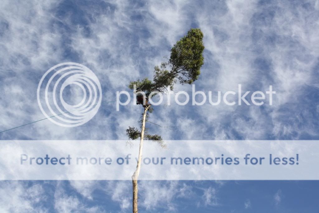

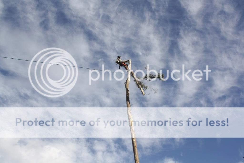

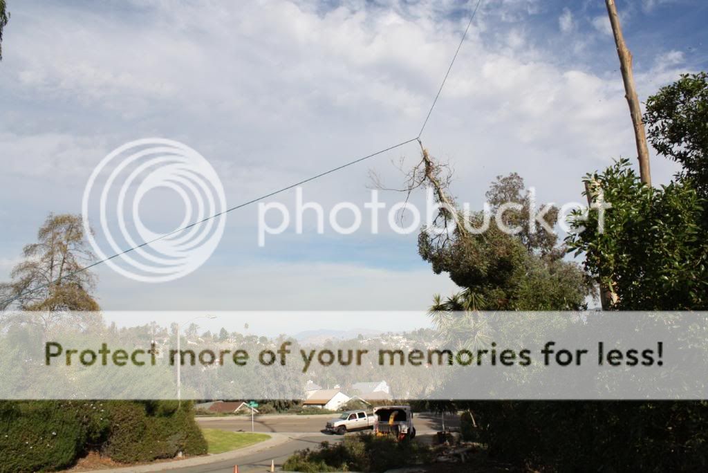

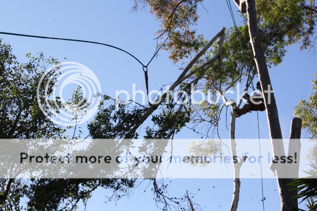

I hesitate to say this, because I'm sure people with think I'm exagerating and putting on a show, but the truth is, I am tired of speedlines. They have become boring.
If I can do a "no control" speedline like in your photo, over a cool obstacle, that is still interesting and fast enough.
